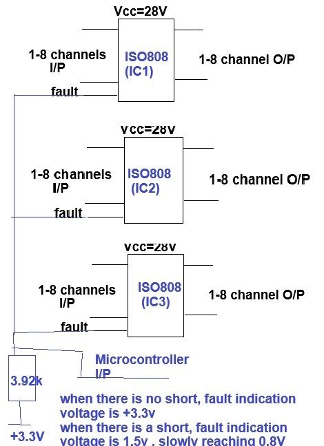

We are using three ISO808 ICs, with their fault pins connected together and connected to a single microcontroller input pin. A 3.92k pull-up resistor is tied to a 3.3V supply, as shown in the attached image. When there is no short, the fault pin voltage is 3.3V. However, when any output is shorted, the fault voltage drops to 1.5V instead of 0.4V and gradually decreases to 0.9V. This fluctuation causes the fault signal to toggle, making it difficult for the microcontroller to reliably detect the fault status. Please suggest a solution to resolve this issue."
