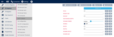

Hi
please enable RX NEG for EPP mode use GUI, or you can use this link epp file.
