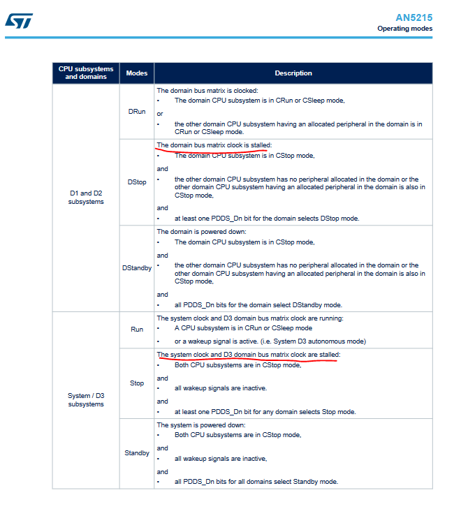

I dont have experience with stm32h, but it looks like when you enter STOP mode you stall the peripheral clock and the peripheral bus clock. So just by looking at the AN5215 id say no is not possible the use the ADC if its clock source is not working.
page 8:
