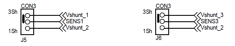

hi I have the ihm08m1 how can I change from 1 shunt to 3 shunt if by default it is soldered on 1 shunt?

Simply set the solder jumpers J5 and J6 accordingly (next to R43/R45), i.e. both to 3sh:

Hello @SDall,
the selection for single/three shunt configuration is made with J5 and J6 jumper.
You have to move the tin drop on the 3Sh side.

2022-03-03 3:36 AM
do you have to do it with the welding machine?
2022-03-03 5:57 AM
Yes, J5 and J6 are solder bridges.
