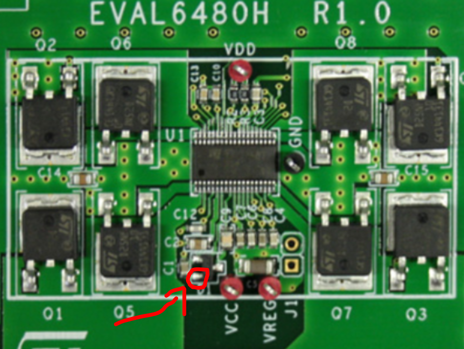

I measured the voltage and
VCC = 7,5V and the voltage for the high side can be calculated with the formula:
Vboot - Vs
I can measure the Vboot voltage on the board. Its the voltage on C1. In this pdf [3] on site 5, the circuit diagram tells me that Vboot has a connection to C1 and BAV9 (D1 on the L6480 PCB).
So i measured the Vboot voltage as shown in the figure below.
Vboot = 18V.
If I now do the calculation:
Vboot - Vs = Voltage_high_side
18V - 12V = 6V
6V are enough to get over the turn on threshold as described in datasheet site 30 section 6.10.

Hello @Evdsl.1 and welcome to the ST Community.
The "VBOOT - VS" UVLO turn-on threshold have the following values (see L6480 datasheet in Table 5 page 12):
The typical value is 6 V but the maximum value is 6.3 V.
In your case you have two options:

2022-03-03 1:13 AM
Hi @Evdsl.1,
if you adopt the first option, it is not necessary change any components.
So, you have set VCC = 15 V (VCCVAL set high and UVLO_VAL set high), right?
Could you check the actual value of VCC?
The board is powered at 12 V and you are using the default supply configuration?
Do you repeat the same procedure described in the original post?
With reference of the point 3 of commands sent: 0x1A Set the Config Reg CS_SD to 0 and UVLOVAL to 0
Have you always received the same response from the get status?
Read GetStatus -> Result 0xe103
Read GetStatus again -> Result 0xe503
