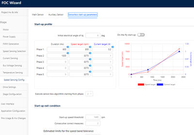

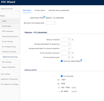

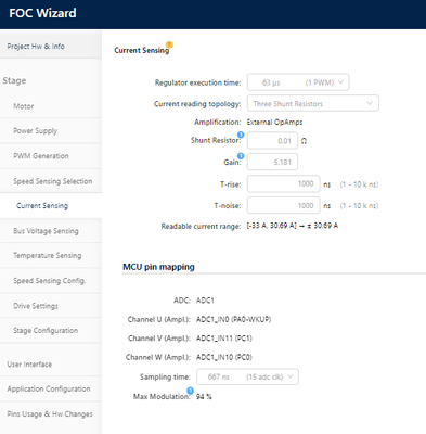

I am using sensorless FOC (STO-PLL) in WorkBench tool. I am trying to increase the speed of the motor to its MAX 47000 RPM. But, I am getting only 7200 RPM with Parameters from Motor Datasheet in MC Workbench tool. I have changed the HW to short 3-SHUNT and removed mentioned capacitors.

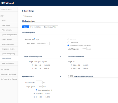

Below are my parameter configurations:

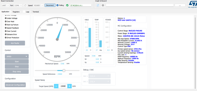

Max speed I am getting on Motor Pilot:

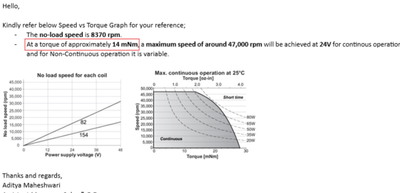

I queried Motor for the Max speed of the motor. They replied it is achievable by using 14 mNm Torque.
I have few questions:
1. In the Motor profiler tool, reaches upto 12000 RPM then giving Speed Feedback error. What configurations can set to run profiler tool successfully?
2. Does ST HW (F401RE + IHM08M1) support 47K RPM @24V for the Motor?
3. With ST workbench tool having Sensorless FOC (STO+PLL), can we achieve MAX speed 47K RPM.
If achievable, please suggest me the parameter values required to configure on workbench tool.

I am unable to save the result in the profiler tool. where i am getting approximately 12000 RPM. The tool is interrupted by Speed Feedback fault. How to configure profiler tool to complete the profiling.
Could you please check and confirm the parameters I have filled in the workbwnch tool are correct or not?
