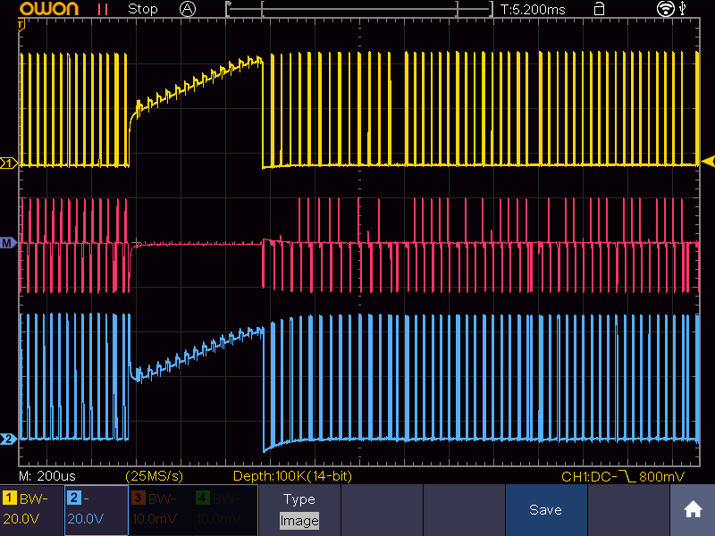

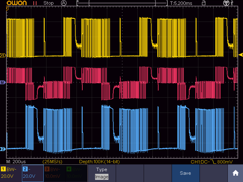

I captured a single phase with Oscope, channel 1(yellow) on PHASE A+ and channel 2(blue) on PHASEA-
The top picture is moving at 40 ips, and the bottom picture moving about 1 ips (at a constant speed)
The pink signal is channel 1 - channel 2.
This is not quite what I would expect
(especially the strange slope when moving at a constant slow speed?, what is that?)

Do you have the "LoSpeedOpt" switched on ? But indeed it looks a bit "weird"... The calculation (in pink) shows basically, what´s going on, from one "full step" to the next one. Every full step it has to change polarity and so at least THIS is correct ;) More or less at the point, when it changes polarity, the "spikes" should become denser, the further it moves to the "center point" and then become lighter until it reaches the next polarity change.
It´s a long time, since i played around with the powerstep01 on my scope :( I really should search, where i have these ihm03a1 boards lying around and connect a motor ;) Without running hardware it´s more than difficult to analyse, what´s going on at your side :(
Which hardware do you use to evaluate the powerstep ? ihm03a1 plugged onto a nucleo ?
Edit: Let me check some literature 1st ;) especially the sequence, when driving a stepper in fullstep mode (just switching the coils ...). As i said: a long time, since i did this and sometimes it´s better to check, if i´m still right ;)

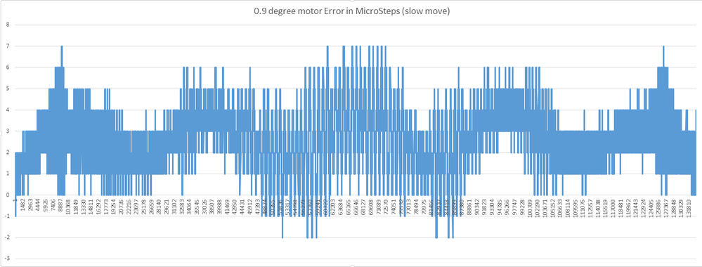

I attached an optical encoder to my stepper motor, and then captured my step pin, and the quadrature data using high speed logic analyzer,
I moved a distance of 6 inches in this plot.
I then plotted the difference in microsteps between my microstep position and encoder position (translated to microsteps).
Does this look normal? Is this normal stepper motor resonance? For x16 microstepping in current mode, I am off from -2 to 7 microsteps.
with a very high frequency oscillation. This definitely explains the oscillations I see in the laser engraving.
