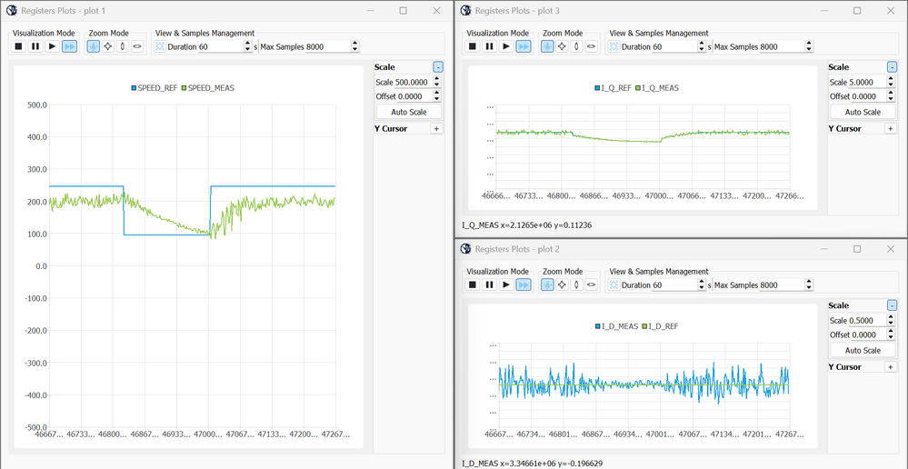

I am using STM32 Motor Control SDK / MC Workbench with sensorless FOC (STO + PLL) to drive a low-speed, high-inertia 24V 40W BLDC fan motor.
Power Board: X-NUCLEO-IHM07M1
Issues observed:
pilot_register_observation
Questions:
For low-speed, high-inertia fan motors, what is the recommended observer / speed LPF cutoff frequency parameters?
Which parameters should be prioritized to:
Reduce speed oscillations
Eliminate intermittent torque/current stepping noise
Reach rated max speed?
Thanks in advance for any guidance.

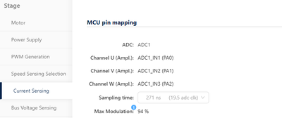

Rated max speed could be limited by the Maximum Modulation Index available in
Reduce the PWM frequency to obtain an MMI value as close as possible to 100%.

I haven’t found a complete solution yet. The issue persists with this low-speed, high-inertia fan load, and I’m currently waiting for feedback from ST support. I’ll update here if I receive any concrete tuning recommendations.
Hi @GMA,
I have not yet received a concrete solution or tuning guideline from ST that fully addresses:
Speed oscillations at low RPM
Intermittent torque/current noise
I am currently waiting for further feedback or recommendations.
If anyone else has practical experience or tuning strategies for similar issue with high-inertia BLDC fan applications, it would be great to hear your inputs.

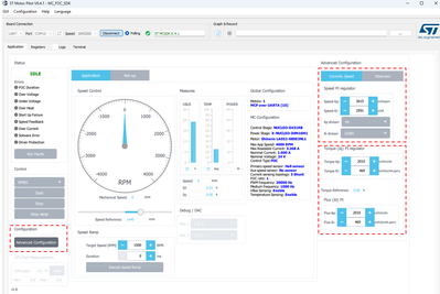

Hello @Mani2 and @Prof_McGonagall,
With the Motor Pilot Advanced Configuration, tune the speed PI regulator parameters to optimize RPM stability. Tune the torque/flux PI regulator parameters to optimize torque response.
