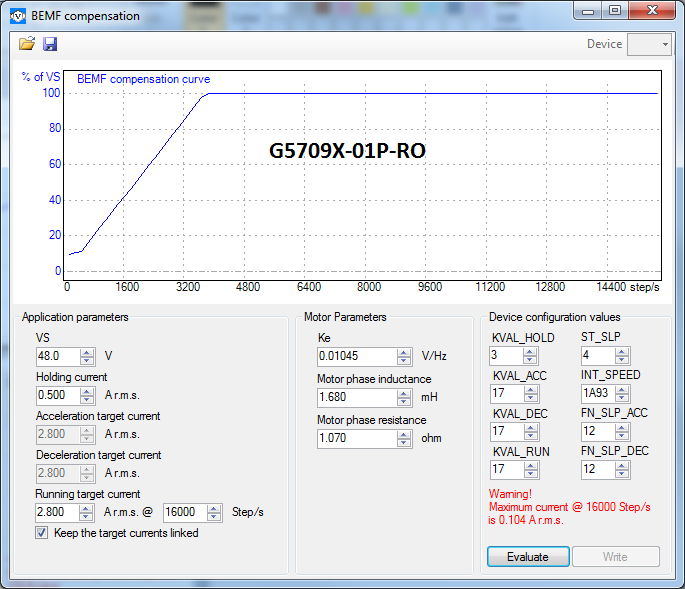

I am using a POWERSTEP01 at 48V in VOLTAGE MODE.
Here are the motor parameters. Also does this calculator assume a 0.9 degree stepper motor?
Is there an inherent speed limit (microsteps/sec) for VOLTAGE MODE?
Why is CURRENT MODE capable of higher speeds, don't they both
run out of voltage at high speeds due to BEMF?
