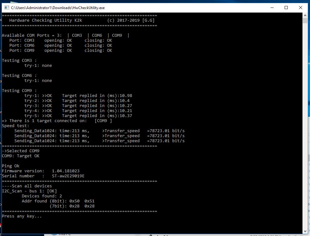

Today on Github I found a HwCheckUtility.exe file. It launches, finds the com port and then indicates it found the I2C device at 0x28 address. I also see the scan on the logic analyzer.

Thanks for this. With 1.07, board not found but HwCheckUtility 1.0.0 found my ISC005V1. With 1.08, I can now see the board.
