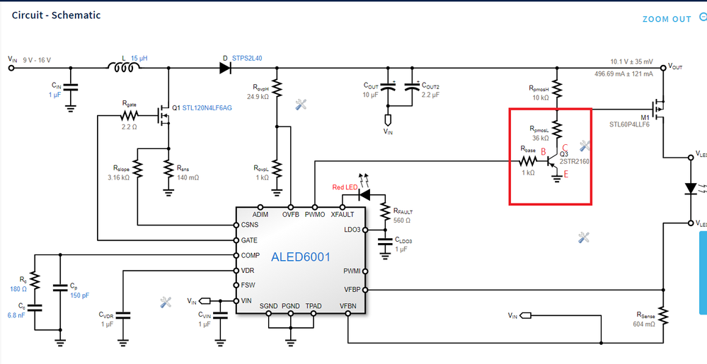

ALED6001 eDesign show BJT is as the red rectangle.

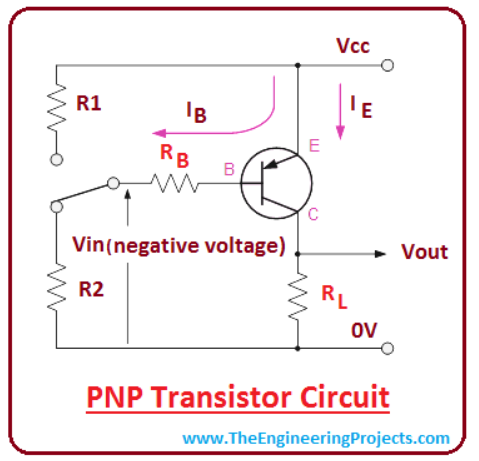

However, most PNP BJT is show as below picture.
I search some data, they show exchanging BJT's E and C, BJT can work.
However, the hfe will decrease and the BJT cannot afford high voltage.

Please don't be confused by the different types of BJT: the eDesignSuite proposes a npn BJT but you are talking about a pnp.
Regards
/Peter
