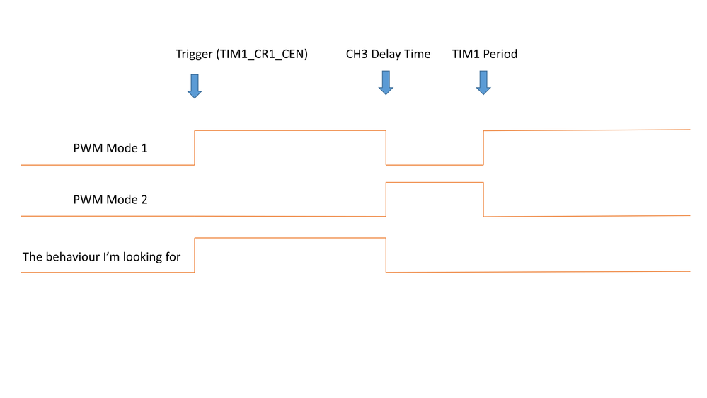

2020-10-20 8:46 AM
Thanks for replying, Cristian!
That would have been too easy :)
PWM mode 1 does not actually produce the behaviour I'm looking for.
Here's what I'm seeing:
2020-10-20 9:28 AM
Well, then after you start the timer pulse by setting CEN bit, change the OCiM bits to 010: Set channel to inactive level on match - OCiREF signal is forced low. This should keep then the low level after the timer period.
2020-10-20 5:27 PM
While doing bit-manipulation of timer registers during each particular timer event might technically work, I feel like it would be inviting a race condition. It also hardly qualifies as elegant -- it rather defeats the purpose of using the timer outputs directly, I might as well set the GPIOs myself and clear them on an interrupt at that point.
But, are there other timer modes that may be applicable? Due to their behavior, it seems like the PWM modes aren't designed to be used for AC synchorized dimming.
The behavior I'm looking for seems like something that "should" be natively supported by some timer mode, because it's such a basic thing -- "keep the output lit while we're counting".
