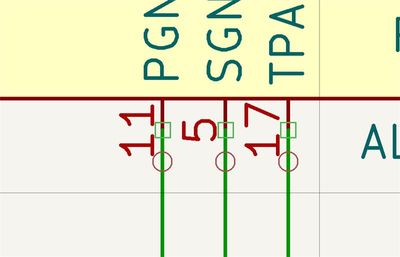

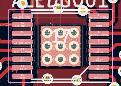

Knochi
Associate II
Found the issue.. looks like I accidentally disconnected the ground from the ALED6001 after ERC and before releasing the design files.
So ALED6001 was not connected to ground, resulting in some strange behavior including pulling the gate continuously to high.
Fixed that now and tuning the PWM generator circuit.

So unfortunately I still have problems.
I fixed the ground connections with enamel wire and the circuit works, but only when VIN is below 12V.
