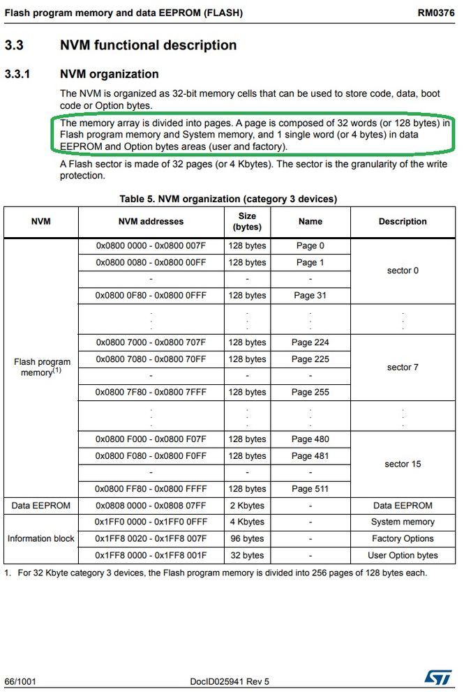

I want to get the details list of registers present in the EEPROM of STM32L072xx

I referred the reference manual, but it is not mentioned what are the specific registers and memory locations inside the EEPROM.

I am not looking for the address range, I am looking for the available registers inside the address which is user writable.
