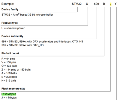

2024-11-26 11:39 PM
Thanks for the feedback FBL. It was really helpful!!
I totally overlooked the fact that those chips can have either 2 or 4 MB of flash. Now that makes sense.
