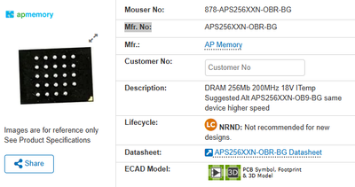

I'm working on a board, wherein i am using DRAM 256Mb 200MHz with Mfr. No: part no APS256XXN-OBR-BG (as recommended in STM32N65 DK) but while going through it i found that this part no is not recommended for the new design. Can anyone please share the alternative of this part no or guide in this.

Reading the description the suggested alternative is the APS256XXN-OB9-BG.
