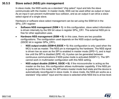

Again, check with the LCD driver datasheet. Most SPI transfers happen as combined transfer, e.g. SPI slave internal register first, value to write next. To finalize such a transmission, a L->H transition of /NSS is usually required.
Here the respective section from the STM32F303 RM as example:
SPI is not as "standardized" as e.g. I2C, you will need specific settings and sequences for different slave devices.
And a scope - or logic analyser - is really helpful the validate your code.
2025-12-02 6:13 AM
@cockatoo wrote:I think I know what is wrong. I have skimmed through HAL_Transmit, and it does not do anything to NSS. But the device expects an edge in NSS every time it starts receiving data. So, I need to toggle it manually.
You would have seen this immediately with a logic analyser (or a scope) !
Note that the behaviour of the STM32F4's hardware NSS control is (probably) not what you require - see the RM extract posted by @Ozone.
