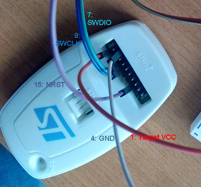

2025-03-12 9:02 AM
@blank_supportgis wrote:The wiring is as shown in my schematic.
The problem mentioned earlier was with mis-interpreting the numbering of the ST-Link - so a correct schematic didn't help that.
A good, clear photo of your setup could help.
Stolen from @Jesus Perez here: https://community.st.com/t5/stm32-mcus-products/stm32f070-wont-connect-to-st-link/td-p/357857
Here's one I prepared earlier:

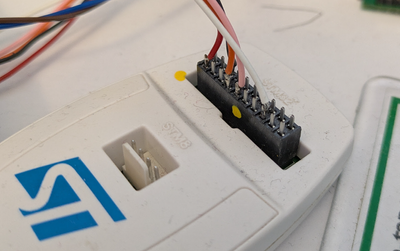

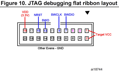

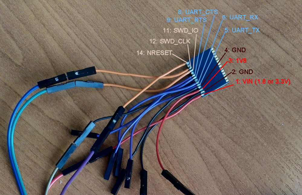

2025-03-13 1:44 AM
I agree, pin 1 can be a little tricky to locate on the ST-Link. Anyway, my connections are definitely according to your pictures, except that I power my board from an external source and therefore don't use the yellow VDD line.
I tried to capture my setup in a picture, which is quite difficult when using jumper wires, but I think, every connection should be traceable (see attachments). The blue PCB is the radar module with pin 1 being located in the lower right corner (red wire).
2025-03-13 2:48 AM
Indeed, the connections do look correct (assuming the radar board is correctly oriented) - but very messy!
Lots of scope for unreliable connections with those multiple jumpers, and the breadboard.
I would certainly suggest that you tidy-up and shorten the wiring
Solder wires onto a header to connect direct to the ST-Link; eg,
Get rid of the breadboard - use soldered connections.
Are you sure that the USB-to-UART unit supplies adequate power? Have you tried with a proper power supply.
Having different wire colours for different signals helps.

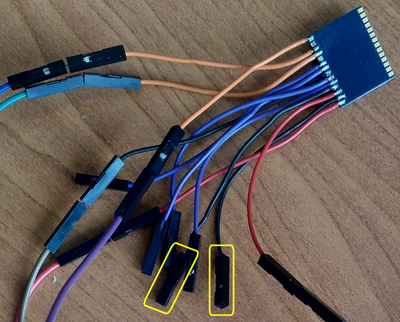

Your two black ground wires are not connected to anything:
You have no ground connection to the radar board!
2025-03-13 5:12 AM
Yes, shortening the wires worked. I'm gonna be honest, I was reluctant to clean up, because I didn't think it would help, but it did.
I've connected all dupont headers I soldered to the XM125 module directly to the ST-Link now, except for the power, which still comes from the breadboard (I need to get my 1.8V from somewhere). So, apparently, the problem was with the SWDIO and SWDCLK connections.
Anyway, thanks a lot to everybody for their help and patience!
