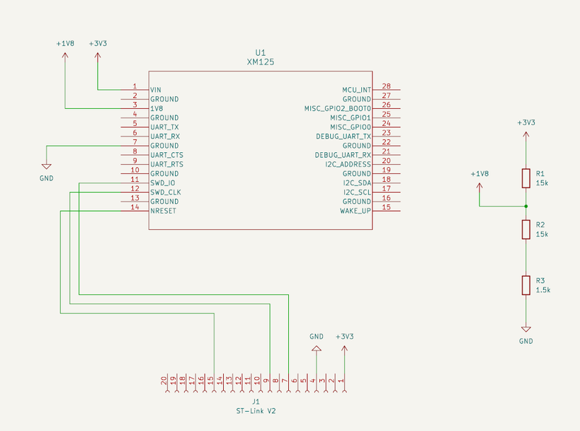

I'm using a serial-to-usb interface stick to generate the source voltage of 3.3V. I'm additionally using a voltage divider to get the 3.3V down to 1.8V, since this voltage is required by the radar sensor. The following schematic outlines my setup:
In the attachments, you find an image of my setup, and my test project.
2025-03-13 5:12 AM
Yes, shortening the wires worked. I'm gonna be honest, I was reluctant to clean up, because I didn't think it would help, but it did.
I've connected all dupont headers I soldered to the XM125 module directly to the ST-Link now, except for the power, which still comes from the breadboard (I need to get my 1.8V from somewhere). So, apparently, the problem was with the SWDIO and SWDCLK connections.
Anyway, thanks a lot to everybody for their help and patience!
2025-03-12 5:58 AM
How much power is drawn on 1.8V? Might be being pulled too low.
Why are most of the grounds not connected?

As for the unconnected grounds, I have no excuse but laziness. I figured, one ground connection should be good enough for testing. Am I wrong here?
2025-03-12 6:23 AM
For STM32 ground pins, they all need connected. I don't have information on how the module grounds connect to STM32 grounds. Probably that's worth checking out. A connectivity check between them might yield an answer.

2025-03-12 6:39 AM
The XM125's datasheet at https://developer.acconeer.com/download/xm125-datasheet/?tmstv=1741766474 shows that all VSS pins and VSSA are connected to ground and all ground pads on the module are connected together.
Sorry for the inconvenience, but I don't feel well posting schematics from acconeer's datasheets without consent.

2025-03-12 7:11 AM - edited 2025-03-12 7:16 AM
Have you tried connecting under hardware reset ?
Does this ST-Link work with other targets?
PS:
Are you sure you have the ST-Link connections correct?
There was a case recently where the problem was misinterpreting the ST-Link pinout...
2025-03-12 8:31 AM
I tried connecting under hardware reset with the same result.
I currently don't have access to other targets, but I can check this tomorrow and let you know. I do have access to another ST-Link however. Same result.
I've checked the connections again using the XM125's datasheet and the ST-Link's datasheet and also verified proper connectivity with a multimeter. The wiring is as shown in my schematic.
