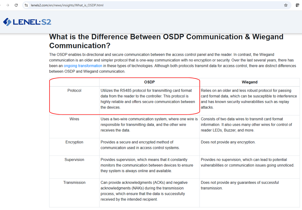

So this: https://www.securityindustry.org/industry-standards/open-supervised-device-protocol/ ?
aka IEC 60839-11-5: https://webstore.iec.ch/en/publication/33414
https://www.lenels2.com/en/news/insights/What_is_OSDP.html
So, as far as the STM32 is concerned, it's just RS485 - ie, a UART connection.
So, as @mƎALLEm said, the only thing that's specific to STM32 will be the UART RS485 part - all the rest will be unrelated to STM32.
