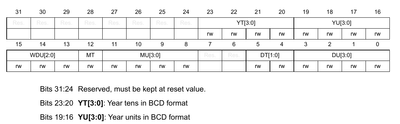

STM32 RTCs store year as last 2 digits. They also have a primitive leap-year calculation that only checks remainder of 4.
So the year will go from 0 to 99 and then wrap (overflow). So a fixed offset of 2000 means the year will fail at 2100.
Also leap years will fail in 2100 as 2100 is seen as a leap year, when it's not.
So they have two year-2100 problems.

But here is not a Unix system, but just a controller with RTC , that has only years 10 + 1 in BCD : 2025 is only "25" in RTC :
So its up to you, how you handle the full date in your software :
if using a uint_16t to store the "full" year, you will get a problem in the year 65536 - if your device still running and in use. How long you expect it working and be in use ?
