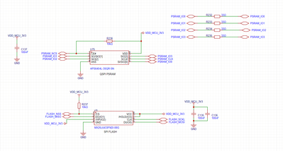

2025-10-25 4:28 AM - edited 2025-10-25 4:32 AM
Here is my current memory section. Please review it and let me know whether it’s correct or if any modifications are required.
