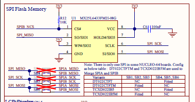

I think MX25L6433FM2I-08G (64-Mbit serial Flash memory) could do the job. Refer to its datasheet here.
That memory has been already used in X-NUCLEO-GFX01M2 expansion board (compatible with many NUCLEO-XXX boards).
From its schematics:
Hope I answered all your questions.

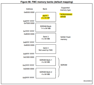

Hello @sudheesh_ and welcome to the community;
From the FMC point of view, the external memory is divided into fixed-size banks of 256 Mbytes each:
Bank 1 is used to address up to 4 NOR flash memory or PSRAM devices. This bank is split into 4 NOR/PSRAM subbanks with 4 dedicated Chip Selects.

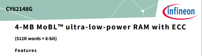

2025-10-16 5:46 AM
Thank you for your response.

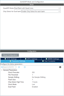

I’m currently facing an issue where SRAM and SDRAM are using too many pins. Since I’m using the 144-pin package, I decided to move to QSPI. I’m using Bank 1 for flash and Bank 2 for PSRAM. This configuration supports memory-mapped read access with QSPI, so I chose this method.
Is this approach correct, or do I need to make any changes? Please provide some guidance.

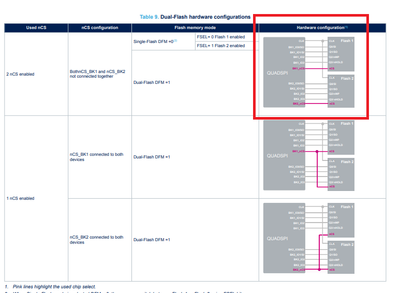

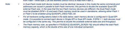

STM32H743 supports Dual-Flash mode but both device models must be identical, because in this mode the same commands and addresses are issued in parallel to both memories:
Please refer to the AN4760 " Quad-SPI interface on STM32 microcontrollers and microprocessors " Page 20.
And in your case you are planning to use two different devices Flash and SRAM!

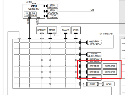

May be you need to change the package of the MCU for a bigger one .. Or change to another product STM32H72x/H73x that has independent OCTOSPI:
For OCTOSPI usage, please refer to the AN5050 "Getting started with Octo-SPI, Hexadeca-SPI, and XSPI interfaces on STM32 MCUs"

Thank you @mƎALLEm .
You are right, but I’m using different data lines and different chip select pins for each bank. Is this approach correct?

I don't think it's possible. As said in the application note AN4760 both devices needs to be the same devices:
See page 21: this is your case:
But the note (page 20) says the following:
2025-10-16 7:55 AM

Switch to another product as I said in my previous post:
"change to another product STM32H72x/H73x that has independent OCTOSPI:
For OCTOSPI usage, please refer to the AN5050 "Getting started with Octo-SPI, Hexadeca-SPI, and XSPI interfaces on STM32 MCUs""
