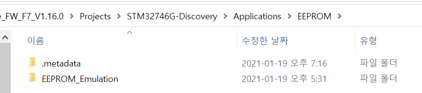

Can I use the photo file downloaded from STM32Cube_FW_F7_V1.16.0?
I tried using both of the provided folder files, but it didn't work out, so I'd like to ask you again.
