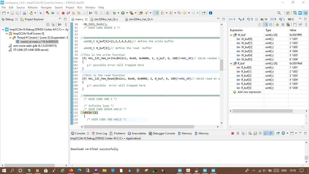

2021-01-25 5:18 AM
Hello
This is a working example made for this purpose.
Dont forget the pullup resisrors.
Here is the code
uint8_t W_buf[6]={1,2,3,4,5,6};// define the write buffer
uint8_t R_buf[6];// define the read buffer
//This is the write function
if( HAL_I2C_Mem_Write(&hi2c1, 0xA0, 0x0000, 2, W_buf, 6, 100)!=HAL_OK)// 24c16 random rwrite at address 0.
;// possible error will trapped here
//this is the read function
if( HAL_I2C_Mem_Read(&hi2c1, 0xA0, 0x0000, 2, R_buf, 6, 100)!=HAL_OK)// 24c16 read at address 0.

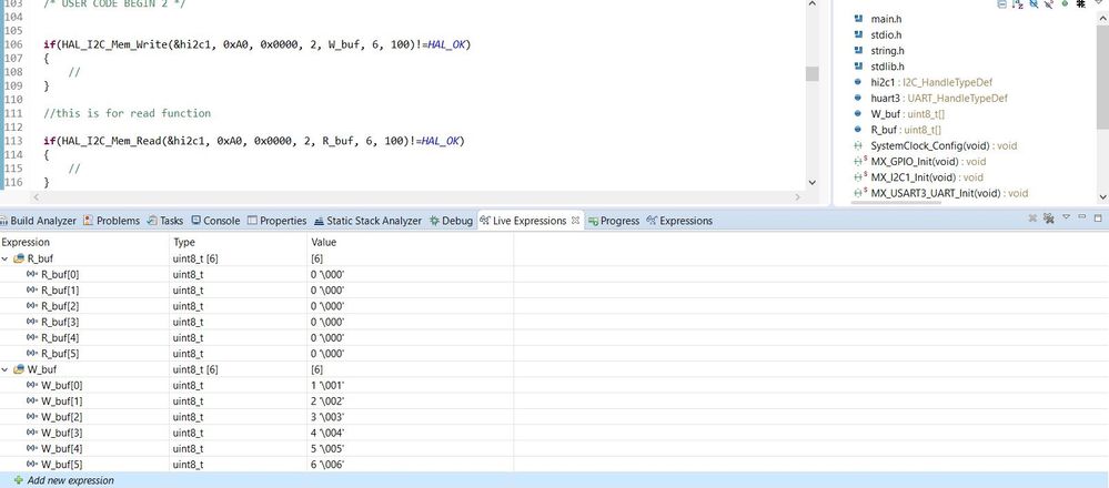

2021-01-26 7:54 PM
Thank you soo much.
2021-01-26 9:16 PM
Thank you sir. I tried as u told it is working but in R_buf the values are not storing. I don't know what to do. Plz help me sir.
2021-01-27 6:18 PM
Hello
It seems that Read operation or write are failed.
probably by some harware issue.
Note that pullup resistors must connected to SCL and SDA lines.
WP pin must grounded
