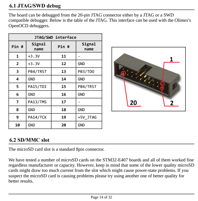

The board's debugger pinout is described in the User Manual:
https://www.olimex.com/Products/ARM/ST/STM32-E407/resources/STM32-E407.pdf#page=14

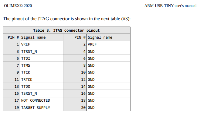

It matches the pinout of the ARM-USB-TINY-H - so you can just plug it in:
https://www.olimex.com/Products/ARM/JTAG/_resources/ARM-USB-TINY_and_TINY_H_manual.pdf#page=10
