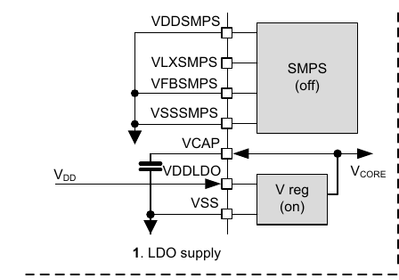

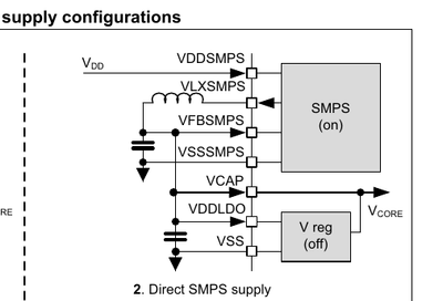

Power configuration is shown in the following schematic:

so you use direct-smps :
- but i see no connection vfbsmps -> vcap ??
- whats core voltage at vcap ?
- you have 3v3 at vddldo - but "not used" written there; but for direct-smps-mode it should be connected to vfbsmps+vcap !
Something wrong : your connections or your info here. Adjust it.

Yep, looks like I missed the connection of VCAP and VDDLDO to VFBSMPS. Will check next week. Thanks for the spot.
2025-09-25 4:09 AM
Connecting those lines up fixed the problem, thanks
