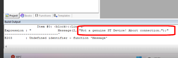

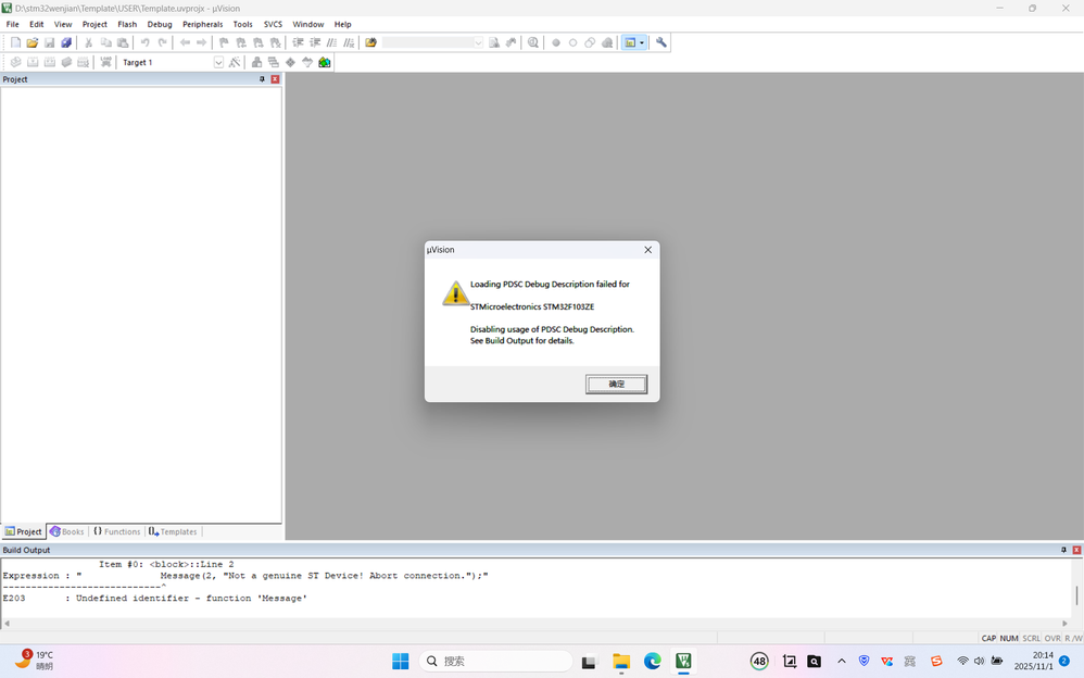

Couldn't understand a thing in this, but STM32F1 with "Not a genuine ST Device" tells enough?

As @Pavel A. said, this is likely the key:
@luwei wrote:
Unclear whether the "Device" mentioned there refers to your target microcontroller, or to your ST-Link - maybe both.
Looking at what came before in the 'Build Output' might clarify that...
How to check your ST-Link: How to recognize a genuine ST-LINK/V2 versus a cloned one.
Example here of someone using Keil with a fake STM32:
Blue pill (STM32F1) programs OK via Arduino IDE but not Keil. Chip ID:0x2BA01477.
