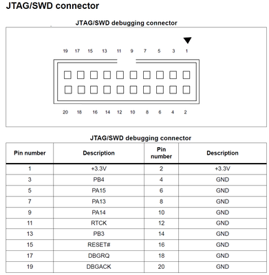

2024-10-15 1:41 AM
This is what I'm talking about STLINK:
V2: https://www.st.com/en/development-tools/st-link-v2.html
or
V3: https://www.st.com/en/development-tools/stlink-v3set.html
Since you are using STM32CubeIDE, I don't know about the probe you are sharing and if CubeIDE supports it.
And the board needs to have JTAG connector with Serial Wire Debug (SWD) support.
This is the 20 pin connector you need on your board:
Otherwise you need to get the signals by wires.

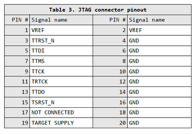

2024-10-15 3:15 AM
Hello Soflit,
Thanks for your reply.
Yes, this is almost what I have for the JTAG. Even some more signals :
But I think it will work. The manufacturer, Olimex, claims it is compatible with STM32CubeIDE.
Now the issue is that this JTAG <-> USB cable powers up the board for a few seconds then shuts it down slowly (the RED Led which should be blinking goes down slowly)
I am now reading the user's manual of this cable from first phrase to last phrase trying to understand what's happend ?
