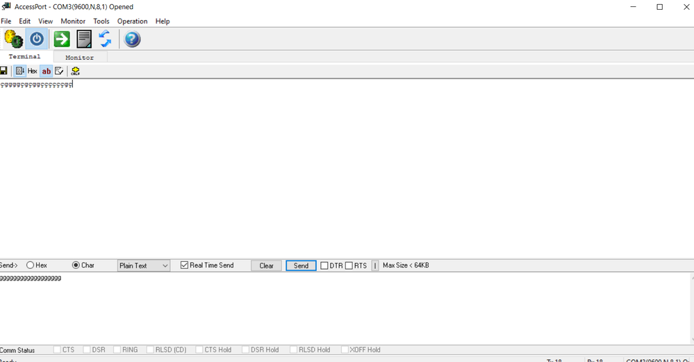

I have tried your recommendations but alas still have the issue. I don't think its noise as its either one of two characters not just random ones. Furthermore, I set the baud rate so there is no remainder when it is divided to fit into the BRR register also to no avail.
The offset between the two characters that I receive seems to 128 decimal which is undefined in the ASCII table. I am at a bit of a loss now
