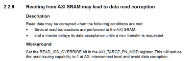

Example, this errata for STM32H743 rev Y:
Was implemented in system_stm32h7xx.c:
/* Change the switch matrix read issuing capability to 1 for the AXI SRAM target (Target 7) */
if((DBGMCU->IDCODE & 0xFFFF0000U) < 0x20000000U)
/* if stm32h7 revY*/
*((__IO uint32_t*)0x51008108) = 0x00000001U;
