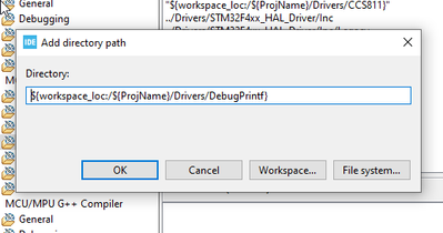

When I include libraries into my stm32 project I drag and drop a folder (from the windows explorer) int the project predefined folder "Drivers". In a second step I need to set the paths for the C-compiler, C++ compiler and linker seperately.

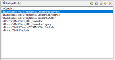

To do so I open the procect preferences and add a path for the C compiler: In this case The project name is TST_CCS811. and the folder to add is DebugPrintf. I click ok. - path for this folder set.
I continue to do so for the C++ compiler and the linker. The path is always the same - it works - paths set.
Now I want to add the next folder in this case GPIO_CPP.

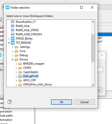

To do so I click on the C compiler again but now - very strange - another project appears in this case TST_BME280 and not the TST_CCS811 which was selected before.
This is very annoying: If you do not recognize this strange behaviour you will add a wrong path (of another project) to jour compilers. It can take very long to find this error - trust me!

Have you renamed or cloned any of the projects?
TL;DR the Eclipse "virtual filesystem" is cool - but can become deceitful. Prefer ${ProjDirPath} instead of ${workspace_loc:...} constructs.

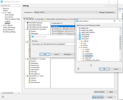

If I shall use ${ProjDirPath} instead, how do I enter this in the IDE? usually I click on the "workspace" button.

These Eclipse macros can be entered almost in any place where you specify project settings: in C/C++ include directories, other file paths etc. Also you can define your own variables, in Properties-> C/C++ Build -> Build variables.
Unfortunately the Eclipse version on which CubeIDE is based does not allow to specify project-related paths in include dirs dialog, only "workspace path" or filesystem. It offers to create project-relative paths in other contexts.
I just edit these paths in settings manually. It is annoying but works for me.
