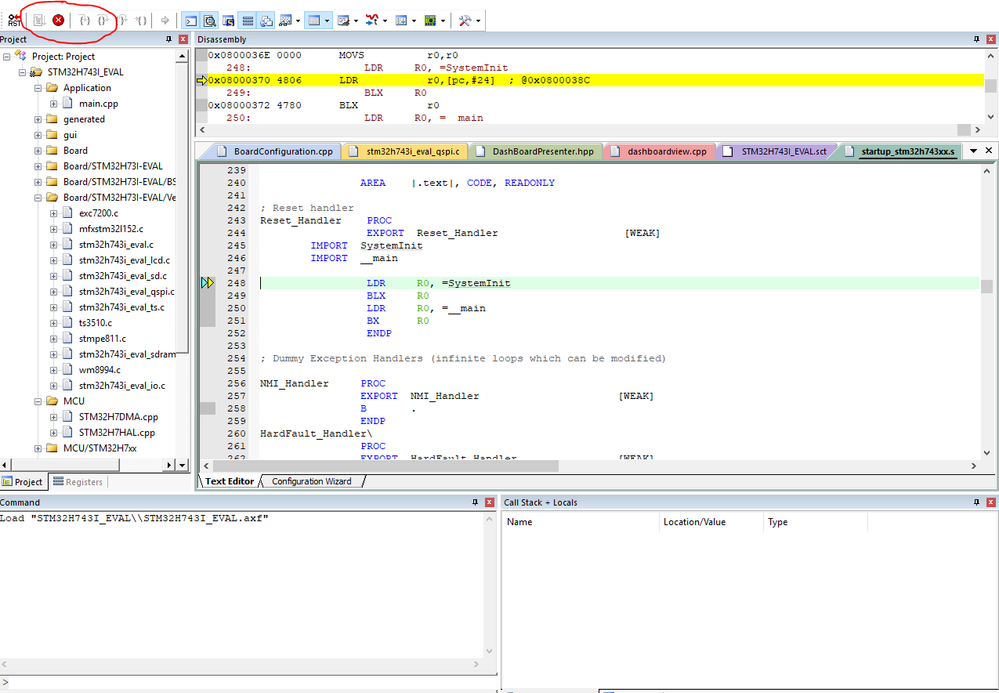

SystemInit faults? Perhaps step in to that and review the code. Inspect Hard Fault location reported by processor, it has registers for that.
Are you using RAM which needs a clock enabled?

I have enabled the appropriate clock ,and I cannot check the register cause it can`t run normally,just stuck in Reset_Handler.

Use Stop to see where it is.
Turn off the "Run to main()" setting of the debugger, and start stepping into/through the SystemInit() function. Determine where things go wrong, and where exactly it ends up.

I found out where the wrong is,and solved it.
