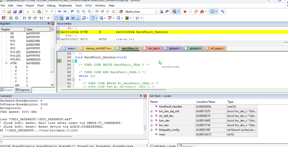

Hi KHALSI_Foued Thanks for your reply,
As we can see above the LR register value is 0xFFFF-FFF9 and call stack local is showing hsc_dev_obj_init lead to the hardfault your suggesting that there is problem in handling main stack (may be stack overflow) so I have tried to increase the stack size and reduce the global variables in the program but still not working.
I don't know how I2C1_IRQ_handler is causing the problem?

do you mean to display all the registers like R0 R1 R2 R3 R12 LR SP PC registers in the hard fault function.?
In Debug mode I executed step by step instructions when I try to execute
dev->ops = NULL of hsc_dev_obj_init function it is leading to hardfault.
