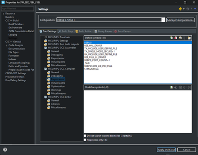

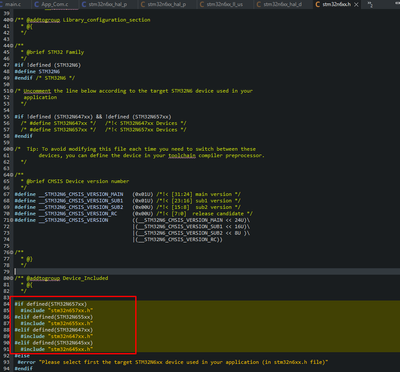

I am working on USB Device VCP project but I have problem about defines,index,etc. As you can see below that I have definition of "STM32N655xx" but I can not include "stm32n655xx.h".
I tried Index, Rebuild step but it did not fix. On the other hand, I am also getting this problem for other files. My code is giving hardfault because it can not acces to "HAL_PCD_MspInit" while initializing "HAL_PCD_Init".

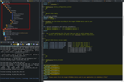

I also forget to mention that CMSIS drivers outside of project folder as you can see below.

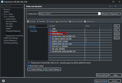

I have "STM32N655xx" define inside of this projects but this folder can not acces to this symbol. If I can fix this, problem will be solved but I do not think that I have to do anything for this problem. Is this a bug?

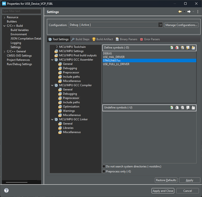

Can you check the symbols definition under C/C++ Build > Settings
