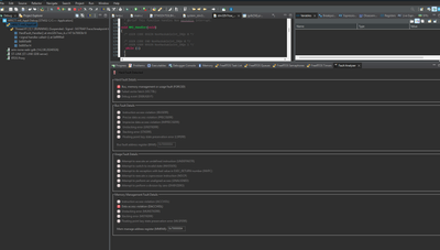

Immediately in the application I hit a HardFault. ST’s Fault Analyzer shows:
  • HardFault: FORCED
  • ConfigFault: VECTBL (Failed vector fetch)
  • BusFault: IBUSERR/PRECISERR set
  • BFAR = 0x70000004
  • MemManage: DACCVIOL set
  • MMFAR = 0x70000004
So the core tries to read the vector table entry at 0x7000_0004 and it gets blocked → HardFault right at exception entry.

I honestly cant see my mistake here. Can somebody tell me what i am doing wrong?
