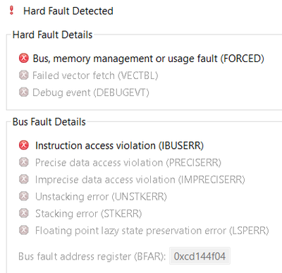

So when I debug it and let it run, I jump to the HardFault_Handler(). The Fault Analyzer looks like this:

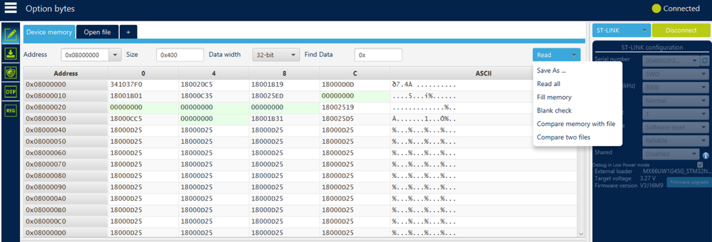

Unfortunately under the OB tab I can not find the option Reset MCU to factory settings. It looks like this:
And as far as I know, I didn't program any option bytes, at least I didn't do it on purpose.

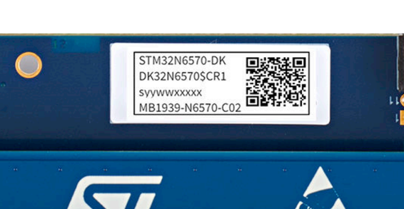

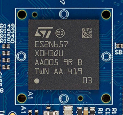

Please find below the images you need to check:
