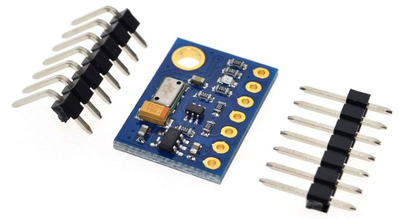

It seems that 3rd-party breakout boards are also available; eg,
https://www.amazon.co.uk/MS5611-01BA03-Atmospheric-Pressure-Altimeter-Electronic/dp/B07Y1QZKF4
