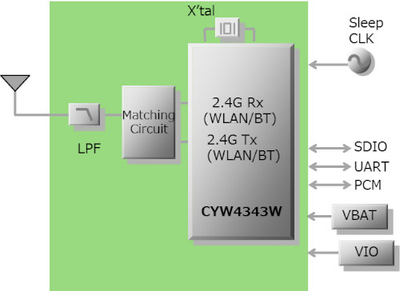

The Block Diagram shows that it's a CYW4343W chip inside:
https://www.murata.com/en-eu/products/connectivitymodule/wi-fi-bluetooth/overview/lineup/type1dx#block-diagram
