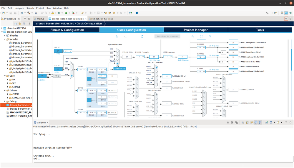

the clock for spi is connected to APB2 which is 25 MHz. I have attach the photo of the clock configuration of the above project.
and the stm32 datasheet stm32 datasheet which we are using.
