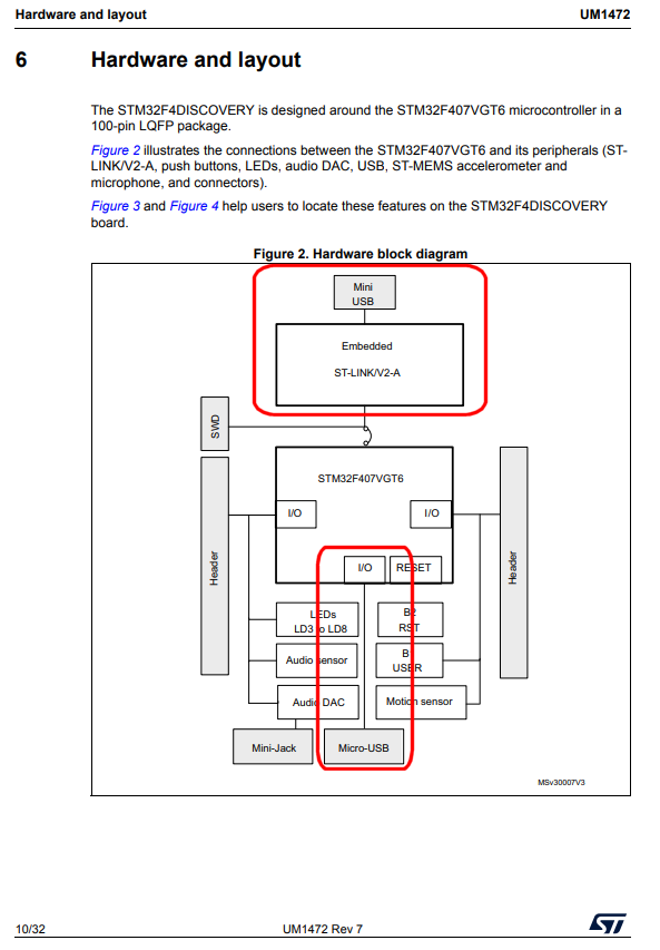

@Andrei Chichak wrote:The Discovery-F4 board has two USB ports, one for the debugger module (ST-Link), and the other connected to the '407 processor.
Indeed.
@SElli.11 this is all described in the User Manual:
via: https://www.st.com/en/evaluation-tools/stm32f4discovery.html#documentation

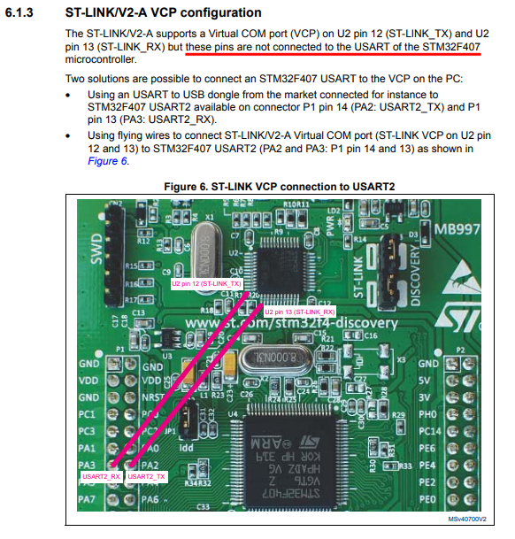

On this board, note that the ST-Link's Virtual COM Port (VCP) is not connected to the Target MCU - you have to wire that manually yourself:

As noted above, remember that the VCP is not connected to the Target MCU on this board - you have to manually wire it.

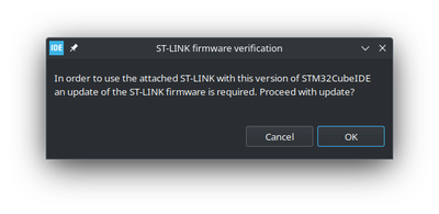

I'm also having a problem with STM32CubeIDE. I have put together a small "blinky" program. This compiles cleanly with zero errors or warnings. However, when I try to upload this to the board, the IDE generates the following dialog.

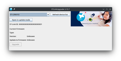

When I click the OK button the following dialog appears.
As can be seen, the update button has been greyed out. How then do I upgrade this ST-LINK/V2 ? Also, is this a piece of hardware or software ? If hardware, this might be the source of my problems all along. if it is software, I do(!) have ST LINK (Stlink Tools) installed, if that is any help.
