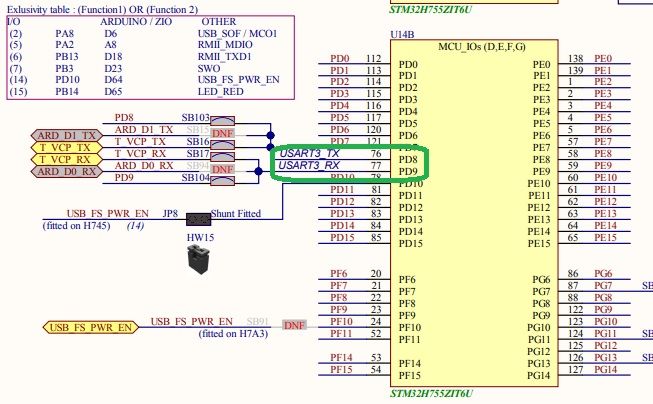

2025-04-14 12:47 PM
The USART on the NUCLEO is physically wired to the ST-LINK's MCU, so you can't randomly change the selection to entirely different pins. If you use different pins, you'll need to attach a USB-to-CMOS Serial type adapter to access the new signals.
For a schematic for the board, go to the board's home page, and click on the "CAD Resources" tab
2025-04-14 12:52 PM
https://www.st.com/resource/en/schematic_pack/mb1363-h755ziq-d01_schematic.pdf

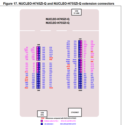

you agree that in the schematic, PD8 and PD9 are in that configuration, but in fact the problem is not them, these two pins work correctly.
Just one thing though, on the NUCLEO-H755ZI-Q, how can I connect them? correct me if I’m wrong, but in the diagram where all pins are represented, these are not there.

What I'm saying is the pin choices are not driven by your imagination, but physical plumbing on the board you've chosen.
You can pick other pin pairs for USART3, but these aren't connected to anything that's going to output to your terminal application. You will need to physically connect something to these new pins to observe the output. This could be a scope or logic analyzer if that's sufficient to confirm the signals are present.
The H755 provide multiple ways to escape different peripheral pins, the AF (Alternate Function) mapping is described in the part data sheet. The wiring manifested on the board is best described by the schematic. You can see which are committed to specific functions, and which are still free to use, and access via the pin headers.
2025-04-14 1:35 PM
To escape PD8/PD9 you'll probably need to make/break some solder bridges so they appear at the Arduino D0/D1 header positions.

@Simontom wrote:Also when I went to change the pins, I first checked on the datasheet that they had the necessary procedure.
So they are not random changes.
The datasheet just tells you about the chip itself - not the external wiring on the Nucleo board.
The external wiring on the Nucleo board connects PD8,9 to the ST-Link's VCP.
So if you change your chip configuration to anything other than those pins, it will not be connected to ST-Link's VCP - therefore you will have to provide your own wiring to make that connection.
Or provide a different USB-to-UART bridge (thus, a different VCP).
