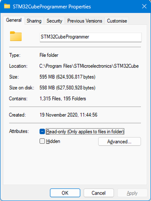

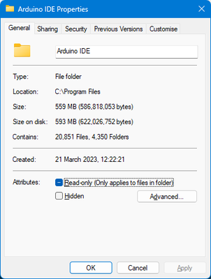

83.5 MiB is very small for a partition these days!
On Windows, the CubeProgrammer installation is nearly 600MB:
and Arduino IDE is 600MB:
