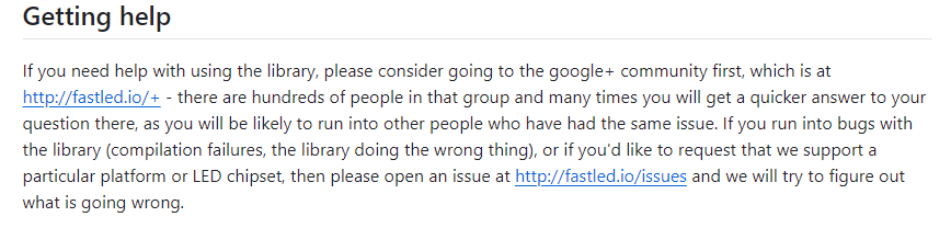

Did you follow the instructions for getting help with that library?
