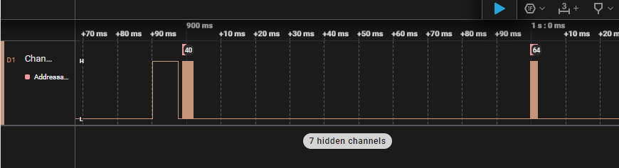

Immediately after power-up, some LEDs (LED 41 an 10-12 following) light up before WS28XX_Init() is even called.
On the logic analyzer, I can see a valid WS2812B data burst right after startup,
covering up to LED 40 with "0", followed by a ~100 ms gap,
and only then my actual data frames appear.
Once WS28XX_Update() runs, everything looks correct and stable.

The picture upload failed...
So its coming from using the WS28xx lib , as TIM or DMA have no native mode to send valid WS pattern.
