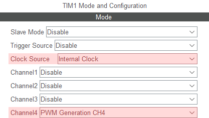

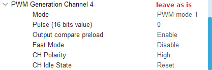

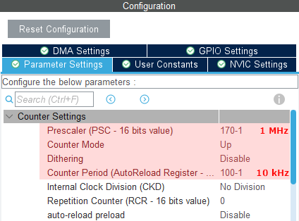

TIM1 Mode + Configuration

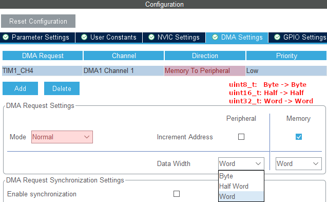

DMA Settings

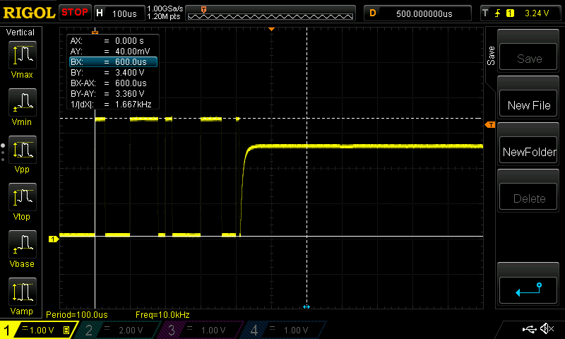

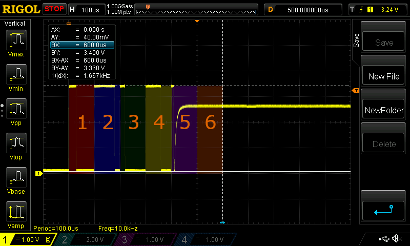

}The result is here:

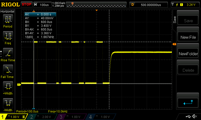

After 4 pulses, the 5th pulse starts but didn't finish
I tried also with Data Width
Half-Word
Byte

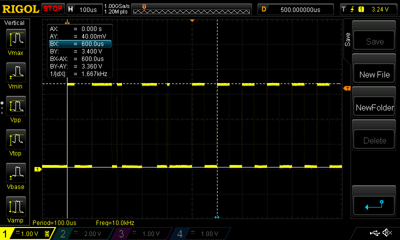

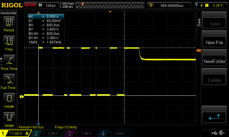

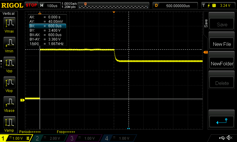

Without stopping DMA, it's like that:
The last puls recurs:

2025-07-19 7:46 AM
The SPI-(or UART-)based solution may be better, but the problem with the timer-based solution is, that you call a function which disables the timer output (i.e. threestates it), as witnessed by the oscilloscope track. Just don't do that. Some Cube/HAL functions may not do what you think they do just based on their name - pending more thorough documentation, they are open source so you can easily look up what are they doing, or just don't use them and program the microcontroller normally.
Here, you don't want to *stop the DMA*. Unless set to Circular, DMA stops automatically when it transfers all data it is set to transfer (in its NDTR register). What you want is a steady output from TIM, and one easy way to achieve that is by setting the respective TIMx_CCRx to zero. So, simply add one zero as an extra element in the array you are transferring using DMA to TIMx_CCRx.

Hello @ABach.4
I tested the example on my side. The signal starts low before the timer initialization and goes high after the timer is initialized. If you want the last pulse to behave normally (i.e., not remain high indefinitely), you need to deinitialize the timer inside the HAL_TIM_PWM_PulseFinishedCallback() function.

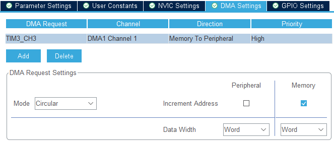

I looked at the example TIM_DMA
Here it uses circular mode, not normal mode (and another timer, TIM3_CH3):
And the period is computed at compile or runtime rather than using the "Device Configuration Tool":

In my example above, I send 6 PWM pulses, but after the 4 pulse, the 5th pulse starts but didn't finish. There is no 6th pulse anymore. So HAL_TIM_PWM_PulseFinishedCallback() comes too early, not after the 6th pulse but at the start of the 5th pulse and stop the DMA too early.

Primary understand DMA width, why is here byte or word. Exactly require equal with peripheral data =
