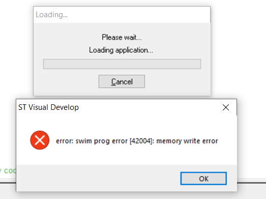

I have build my application and when I click on ''start Debug'' in STVD, below error comes
Debug Seesion:
Starting debug session...
-> Emulator reset (usb://usb)...
done.
Opening application C:\Users\Micro\Desktop\STM8\STM8S105\led\Debug\led.elf...
-> failed to download application: error: swim prog error [42004]: memory write error
Application closed.
Debug session closed.

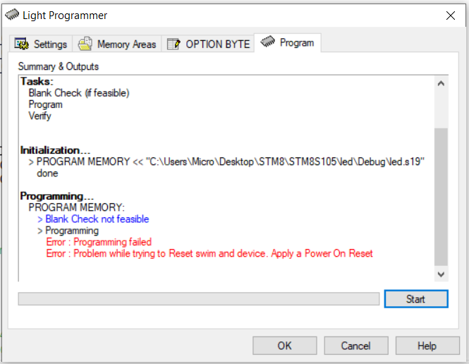

2. When I am Trying to Program using STVD in-built Programmer, it is showing below error:
''STVD > Tools > Programmer'' or using STVP.
Programming...
PROGRAM MEMORY:
> Blank Check not feasible
> Programming
Error : Programming failed
Error : Problem while trying to Reset swim and device. Apply a Power On Reset
The interesting thing is, sometimes the MCU is getting programmed (LEDs are blinking as per requirement) but the software is showing same error message as above.

2021-04-04 8:35 PM
I am also facing the same issue.
Please check this : https://community.st.com/s/question/0D53W00000gfqjeSAA/stm8s005k6-swim-prog-error-42004-memory-write-error
Did you managed to solve it ?

2021-04-07 8:24 PM
And more over, Option Bytes and Data Memory write is working fine. Program memory read is working fine but write is failing.
