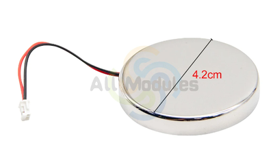

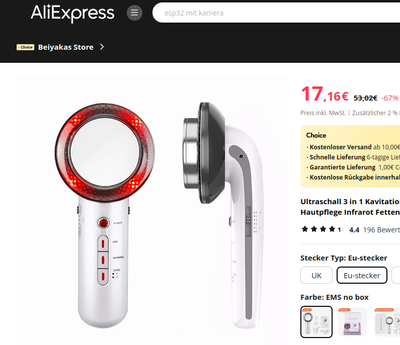

Is your piezo something like this:
or this:
(from Ali express , you should find it more easy than me...)
And there is the driver inside, maybe 10W max. ; but i would guess, interesting to learn how they do.
https://de.aliexpress.com/item/1005005859729805.html

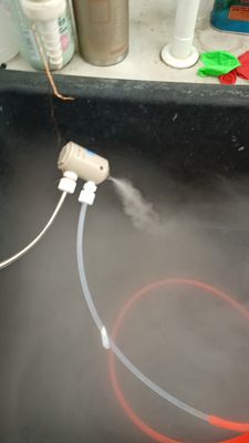

The shape of the ultrasonic is as follows:
It is timely for you to recommend this software to me. I just realize that I need a good circuit design software to help me learn, and I will spend time to study this software carefully
