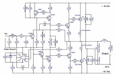

2024-04-22 11:02 PM
ok, now i know somewhat about the target .
Just thinking ... 50 r load, 40W -> 48V ; needs about 136 Vss , so need +/- 70V supply, or 70V with H-bridge,
with about 2A max current; should be possible, to build something, just using 2 mosfets as output devices;
maybe (old) IRF630/IRF9630 or 2SK1058/J160 could be used for AB half-bridge at +/- 70V supply .
basically an audio amp:
BUT : how much skills / experience you have, building something like a 100W audio power amp ?
still no info : whats data of piezo ?
show circuit of 50 ohm "matching" circuit , transformer etc.

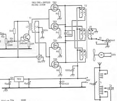

2024-04-23 12:46 AM
hello
I am not particularly familiar with audio power amplifier, it is the first time to contact, so I hope the power amplifier circuit can be simple, similar to Figure 1(this is the online 3MHz-28MHz,100W power amplifier)

2024-04-23 1:51 AM
so without practice in building such an amp, i would recommend:
- if some money available, try with ready made amp module, i searched and found :
https://www.60dbm.com/product/50w-wide-band-1-55mhz-power-amplifier/
...for example, should match,what you want: 50 r output, 50W , 1MHz...
No need to buy this, you could find many others (but most expensive also).
- to learn and build , begin with some 10W amp or so...will be a long way and many killed transistors - but possible.
just an example : 50W possible, but some "funny" work, to make the transformers :)
