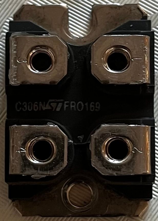

Does anyone recognice this part?
It`s marked with C306 (ST- Sign) FRO169.
It looks like a transistor or diode in SOT-229 package.
Thanks!
Frank

Ah, that explains the marking FRO169. Documentation for such customer-specific devices, which is always subject to an NDA, is held exclusively by that customer - in this case, Fronius. If you do not receive any documents or guidance from Fronius, unfortunately no one else can help you.
But at least you have already figured out the pinout; together with the maximum D-S voltage and the MOSFET’s maximum current, you can already draw conclusions.
Good luck!

Welcome @Essi, to the community!
It is a device in the package type ISOTOP. Could you please check the long sides, i.e. on your photo the left and right sides, whether anything can be read there?
Additionally, it would be helpful to know where the device was used and, if possible, also its immediate circuit neighbours.

Well, even with a MOSFET, e.g. the STE36N50DK, which was discontinued a long time ago, or IGBTs and TRIACs diode paths are measurable. If the device is not completely destroyed, MOSFETs still have the always-present parasitic diode path between drain and source; devices such as the STE35N50DK mentioned also have an additional freewheeling diode.
I agree with you, though: if MOSFETs are already arranged around there, it is probably a dual diode, with the diode paths either between 1-2 and 3-4, or between 1-3 and 4-2, respectively (order A-K each on your image).
Regards

It is probably an STMicroelectronics high-power transistor (not a diode), but the exact model needs the circuit context or picture to be sure.
